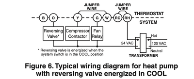

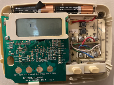

I am trying to determine if the Nest thermostat is compatible with my HVAC setup. I have attached 4 photos
1. From the White Rogers 1F78 user manual showing the setup

3 and 4. Actual photos of the wiring

Your current thermostat is compatible with any of the Nest thermostats.
Try this wiring,
White - Y to Y1 or Y (jumper to W not needed)
Red - RH to Rc or R (jumper to RC not needed)
Green - G to G
Blue - O to OB or */OB
The "or" is for the Google Nest Thermostat wiring
