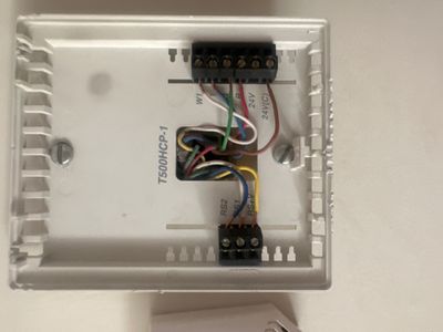

I have three thermostats in my house. I purchased 3 nest thermostats I changed 2 with no problem went to change the third one. There was wires connected where the other two didn't have any don't know what they are for somebody. Please tell me what these wires are on the left side of my thermostat.
 RS2. RS1. RS+V

the RS terminals are for an outdoor or indoor remote temperature sensors. They can be ignored as they will not be needed or used by the Nest thermostat.

So I can go ahead and use those wires on the right side and connect them to my new nest thermostat you say ignore the RS wires. What should I do with them? Push them into the wall thanks for your help. I've been trying to figure this out for three days.
Alex,
If you have enough slack in the cable, pull it out a few inches and wrap the unused RS wires around the cable itself and slide the cable back in the hole in the wall.
Ken, AC Cooling Wizard
