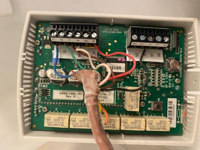

 Is my AC compatible with Nest Thermostat?
Hello Bandidazo,
Thanks for reaching out to the Google Nest Community Forum. I'd be happy to take a look at this for you.
Your thermostat's wiring appears to be Nest Thermostat compatible. To ensure its compatibility, could you confirm the A terminal's purpose? Is this an HVAC accessory such as a humidifier or dehumifier? Also, what's the make and model of your system?
Bandidazo
  • It is a Trane Rooftop Heat Pump
  • Wiring picture was taken from Trane Thermostat
  • black wire seems to be used for Economizer/TOD
Hi Bandidazo,
The Nest Thermostat will not handle the function if the economizer controls dampers or outdoor air exchange, as it doesn't support this feature. With the normal connections, it is feasible to modify the present wiring setup to accommodate the thermostat, but I would suggest calling an HVAC professional or an installer to confirm the wiring configuration.
