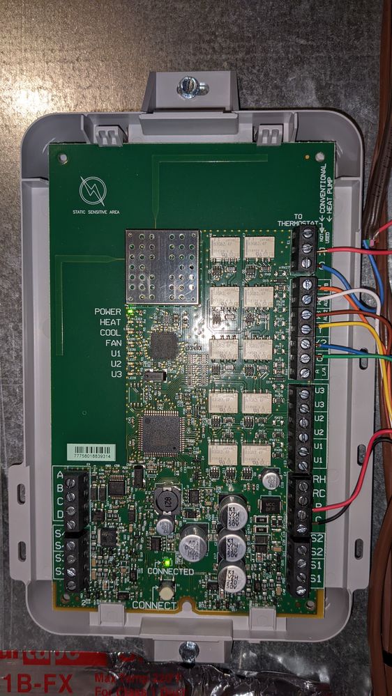

The current Honeywell control board is connected with:
R - red
C- black
O/B - orange
AUX - white
AUX2 - brown
Y - yellow
Y2 - blue
G - green
The online checker tool doesn't recognize the AUX2. Can someone suggest a proper wiring configuration with Nest?

Post a picture of your current thermostat's wiring
Hi Patrick. Do you have any suggestions/thoughts based on my existing wiring?
Thaler
Not sure if it would be any different from my description above, but here it is.
Thaler
The top two (R and C) wires are additional which are provides power to the Honeywell thermostat screen.
So they're not a part of control wires.
