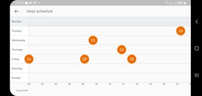

If the display is orange, that would indicate that the heat was set to be on. So I can get a better idea of what the expected behaviour is please take a screenshot of your heating scheduled from the Nest app. This way I can see how it should behave across the weeks.
krzys
krzys
And I only set it up to 20°C
AlexD
From what I see on your schedule you have the thermostat set to heat the location to 28(28.5) degrees from Friday, 08:00 to Tuesday around 22:00. You mentioned this here on the 6th, last Friday that would indicate that it is working like you set the schedule up. Did you notice 28 degrees on other days except Friday morning to Tuesday night? We can also have a look at the history for the heating to get a better idea on the behaviour.

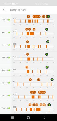

In the Nest app select the heating history at the bottom. This will open up page with past days and a orange bar for each, indicating how much the system was one. Tap on the past days and that will open up a detailed view with orange dots that indicate the temperature and what hour that temperature activated.
Take a screenshot of what you see there, or a few if it does not fit in just one. If you notice any orange dots there that are outside of your schedule, tap on them. That will give you a description on what activated the heating at that point for that temperature.
krzys
That's the problem thermostat didn't itself coz I never set up temp. To 28 degrees
