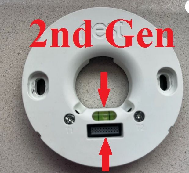

Sadly the 2nd and 3rd gen display are different design, the base plate and stand also changed. The 2nd gen stand can fit, but it's a bodge.
The pictures show the change in design of the base plate,

To be honest I’m a little confused on the information you refer to.
First of all the Heat Link is nothing to do with connection to the internet or Googles direct access. The Heat Link ONLY connects from the display, nothing else. The display is the only connection that Google will any control over for updates.
For example, if you do not connect to Googles app, and just use as a manual connection from display to Heat Link, the system will work forever. Obviously if the unit goes faulty, then that’s a different issue.
Can you explain exactly what you mean by October? The only thing I can think you mean is support, and Google haven’t supported the 2nd gen for years just like the 3rd gen. I cannot remember when the 3rd gen had a software update last,  it I’m sure it’s over 3 years ago.
sorry, for the vagueness. october is when the 2nd gen is removed from the app. i was just concerned that the 2nd gen heat link might be affected by that too.
from what you're saying it's not though, so that's good.
thanks again for all your help, and hopefully i'll never need to pester you ever again!
good luck with your sciatica, it must be miserable.
cheers
bixieupnorth
yes thanks to you i spent a grand total of £84 (less what i'll hopefully get for selling the 2nd gen?) and managed to install it all myself without the need for any expensive professional input.
very disappointed that no one from google came to my aid except humberto who gave the WRONG advice!
that's double disappointment from google, after the initial abandonment from october,  very poor, boo hiss etc!
bixieupnorth
Oh I see what you are getting at now. Yes good old Google have announced they are stopping remote access to the 1st & 2nd gen stats. The stats will still be useable, but not via the app.
I can sort of understand their decision for this, but due to Google having no intention of launching the 4th gen in the UK and not updating the 3rd gen for remote sensors etc., I feel they are as selfish as they always are! The worst thing ever happened was Nest selling out to Google, HUGE amount of issues since these clowns got involved.
Regarding selling your 2nd gen parts, I would be very upfront when listing them. Reason being, if listed on eBay for example and the buyer is unaware, they can claim back on you. PayPal allow claims up to 6 months, which is way after the eBay 30 days.  Therefore anyone purchasing from eBay via PayPal can claim a refund. Sadly I found that out to my cost, so just be aware.
Regarding the selling of the 3rd gen Heat Link. I would not sell that at all, as that’s hopefully a matched pair with your display. Heat Links are one of my biggest sellers!
ok i'll keep that safe thanks, just in case there are problems further down the line, humberto the doom monger still seems to think i'm in trouble come october! i await your reply to his comments with interest!
