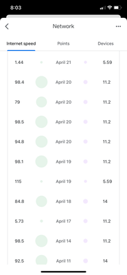

I've had my Nest Wifi (2 pods) working amazing for nearly 2 years. I pay for 100 down and have always been in the 90s consistently until the last 1-2 weeks, when the family has started grumbling that the internet is slow/non-existent.
Running a speed test on the app in the morning when we start in, the speed has lately been creeping <1 Mbps (it was 115Kbps on Tuesday). A restart (pull the power, restart) of the wifi system (not the ISP modem) gets it back up in the 90s. By the evening, it's slow again (down to about 25-30Mbps) and by morning it's <10 and another reboot is required.
When I connect direct to the router and run a speedtest.net, I'm getting great speeds (90s), but connecting back to wifi pods, it's painfully slow. Something on the mesh network is slowing things significantly. Nothing has changed in my setup, I don't have WAN traffic or internal NAS transfers or anything like that happening.
I have the 14150.43.80 update, so I'm suspicious this push has caused the slowdown. Until this resolves, I'm forced to reboot every morning before work, and possibly each night.
I'm hoping for a solution soon. Anyone seeing similar?

I was not having any issues ever prior to approx Apt 17. That’s when I got my first slow speed test results. I only have 1 Nest Router and 2 Wi-Fi points. They were bought together as a package.
As I’ve been trying to debug things in the past week, I’ve been running speed tests in the Google Home app. The act of kicking off a speed test seems to speed the network back up again. I haven’t been restarting/rebooting the network to get it to return to top speed, but just the act of testing speeds things up, as if the router is slowing and then something is cleared out or restarted during the speed test that brings it back to normal fast performance levels.
1.  I notice my computer is loading slowly or failing to load pages.
2.  Run a speed test from within the Google Home app. Test confirms slow traffic, approx 10-20mbps down.
3. Immediately repeat the same speed test from within the Google Home app and the speed test returns a result of approx 85-90mbps down.
Nothing has changed in the configuration, no reboot or reset was performed, but speed has been increased again.
Basically the same.
I only noticed as it seemed things were taking longer to load and streaming services were looking a bit lower quality.
My fix now is to run an internet speed test from the wifi device in the google home app every day or so.

Hi Jeff, thanks for checking in. I've noticed a few more similar reports like this lately, glad I'm not an unique isolated case.
I have seen this continuing recently and potentially getting worse. For example, speed test results from May 19 = {98.4, 1.75, 9.91, 98, 66.5, 54.7}.
I think I did have a brief few days where it was good and I didn't have to run any speedtests. I didn't notice it until I had  about 3-4 days of good performance and wondered what changed. I checked and it was still the same firmware version as previously with the decelerating performance. The only change I could attribute it to was power outages. We've had frequent storms the past couple months and intermittent outages that seem to align with changes. We had another outage yesterday and I'm back to running speed tests on the regular to speed things up again when performance is bad.
