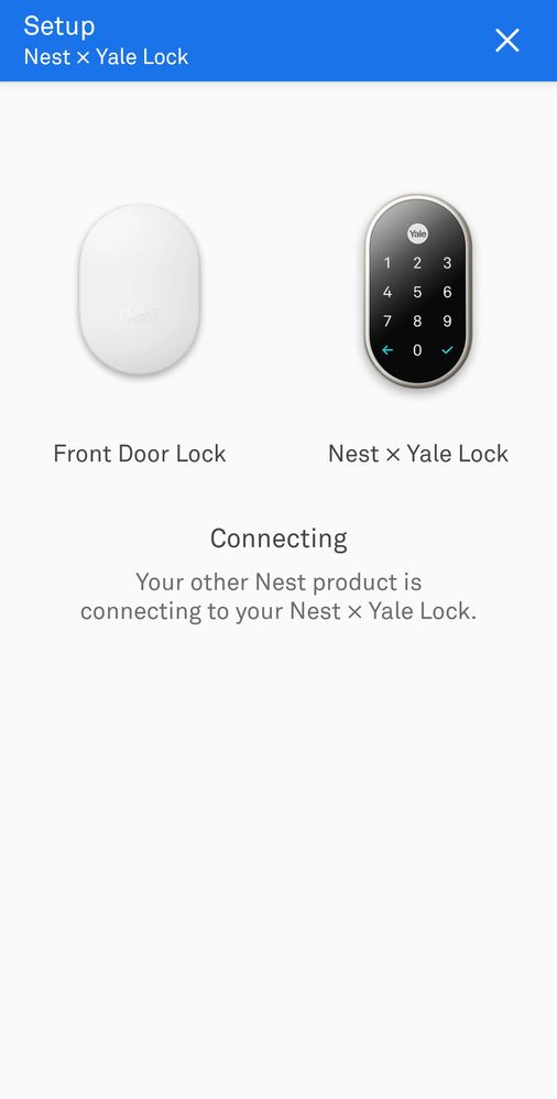

In trying to fix connection issues with my Nest Doorbell, I disconnected my Next Connect. I thought it was what connected the Nest Doorbell to wifi, but I quickly was reminded that it connects the Nest X Yale lock instead... which was removed from my account.
Now, it looks like the Next Connect is connected fine, but the Nest X Yale lock won't connect/add to my account.
1. I've tried removing the batteries for 10 seconds to reset the device. Then Adding the lock to my account. I go through the steps. One step says to hold the main button "until it says it's ready"; but the only thing it ever says is "Privacy mode on" or "Privacy mode off". It never says anything about ready to setup.
So, whenever I get to the connect step in the app it doesn't connect... which takes me back to the screen that tells me to hold the button until it says it's ready. No matter how long I hold it (I've held it up to a full minute) it never says anything other than "Privacy mode on" or "Privacy mode off".
2. I've also tried the Airplane Mode hack... turning on Airplane Mode so that no cell service is used from the phone... but having Wifi and Bluetooth on. Still doesn't work.
One (tiny) positive sign is that my Next Connect has a green light, and when it attempts to connect while adding the new device... The Nest Connect starts blinking blue... so, at least it's trying.
I have not factory reset yet, because... at least my codes still work. I factory reset and the lock becomes a really expensive deadbolt.
Just FYI... I have a separate issue with my Nest Doorbell (wired Gen 1).
Here are some screenshots:

Thank you for posting in the community. I'm sorry that you're unable to connect your Nest Yale x Lock to the Nest app and with your Nest Connect. I understand how frustrating this can be. I appreciate the effort to troubleshoot this situation and for the pictures. I'm here to help.

02-02-2025 10:21 AM
I had the lock (and doorbell - wired Gen 1) connected and working for three years.
My doorbell stopped working. During an attempt to try whatever I could to fix that, I thought I needed to reset my Next Connect... when I did, the door LOCK was removed from my app.
I have an open floorplan house with a router (Asus Zen Wifi) directly upstairs and one in my living room. There is a clear path to the Next Connect.
And, the Next COnnect in 3 feet from the lock, with nothing blocking it.
I have only one Next Connect.
02-02-2025 10:23 AM - edited 02-02-2025 02:55 PM
I tried to connect a new doorbell today, with no success. IT won't factory reset. (After literally 17 tries, it finally reset.)
I tried to connect the lock again, but I had the same issues.
The app says to hold down the button until it says it's ready. But, the only thing it ever says is "privacy mode off" or "privacy mode on". It doesn't say or do anything else.
