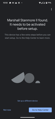

Hi! I've had my marshall wifi speaker set up for about two years now, when yesterday the voice activation stopped working. It reacted to the voice command but didn't actually do anything after. Then I factory reset the speaker and now it won't connect anymore. The Google home up recognizes the speaker but tells me the device needs to be set up first (?). The marshall App doesn't recognize the device at all. The manual states, the speaker needs to be connected to the wifi via the Google home App first.
Any ideas how I can connect my speaker again?
Thanks!

ShellyD
Hi David!
Thanks for the reply! I managed to connect to the speaker via the Device Utility app, but when trying to connect it to the local Wi-Fi i get this error message:
We couldn't authenticate your Marshall Stanmore II. Please visit support.google.com/chromecast for help troubleshooting this issue.
When trying the Google Home app, it gets stuck on trying to connect to the local Wi-Fi as well. Any ideas?

ShellyD
Edit:
After another factory reset I managed to authenticate the speaker but as soon as I choose a local Wi-Fi to connect to I get another error message:
Connection problem during setup
Could not communicate with your Marshall Stanmore II.
I already tried rebooting the router to no avail. Password is correct (copy pasted from my phone's working connection).
I also tried switching on and off the wifi connection as mentioned in the post above.
