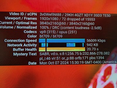

Skywalker27k
Just open youtube, play any video. Display the advanced stats and you'll see the 2 issues.
- Drop frames keep increasing.
- Viewport is stuck at 1080p
This picture was taken after 4min20 of playback. See low viewport and excessive dropped frames. (note: I paused and resumed at 4min, that's why the network bars have a little gap.)
I don't know about viewport in other apps, but I can see the drop frames in all apps.

Hi @ByronP ,
This is not an issue with my settings. I have already checked those settings.
I am actually an Android TV software engineer, the Google Streamer is among the devices I use for my testings.
Try to reproduce the issue at least on youtube please:
  • Open youtube on the Streamer plugged on a 4K TV
  • Play a 4K video
  • Display the "stats for nerds" (or "advanced stats" depending of your language)
  • BUG 1: Viewport is stuck to "1920*1080"
    BUG 2: dropped frames keep increasing. Test at least 5 minutes.
Other devices are able to have viewport at 4k or sometimes it is written "1920x1080*2".
Other devices have zero dropped frames.
