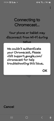

Update 3/20/25
If you previously performed a factory reset, we’re happy to report that the Google Home app update will reach all users today.
Please make sure you’re on version 3.30.1.6 for Android and 3.30.106 for iOS to set up your Chromecast (2nd gen) and Chromecast Audio. Check out this help center article if you need help updating the Google Home app.
If you’re still experiencing problems during setup, please reach out to customer support for further assistance.
Thanks again for your patience while we worked to resolve this issue!
Update 3/17/25:
Thank you for your patience as we worked to resolve the issue with Chromecast (2nd gen) and Chromecast Audio devices. As of today, this disruption has been fixed.
If you did not perform a factory reset, your device should now function normally. If it is still not functioning as intended check the firmware version of your device by following the instructions here. If your device is not on the corresponding firmware version, please try rebooting your device to start the update process.
For users who have performed a factory reset, you will need to update your Google Home app to the latest version (3.30.1.6 for Android and 3.30.106 for iOS) to set up your Chromecast (2nd gen) or Chromecast Audio device again. The app roll out has begun and may take a few days to roll out to everyone. We’ll post a confirmation once the roll out to all users is complete.
We sincerely apologize for this disruption and any inconvenience it may have caused, and we are committed to ensuring all users are back up and running as quickly as possible.

Update 3/11/25:
Hi all,
An update on the situation: the team has identified the cause of the issue impacting Chromecast (2nd gen) and Chromecast Audio devices.
Please do not factory reset your device. If you previously performed a factory reset during troubleshooting, you may also be experiencing an issue where you're unable to re-setup your device. The team has identified the cause for this as well and is currently working on a fix.
We’re working to resolve this as soon as possible, and will keep you updated when there is more to share.

Hello,
We're aware of an emerging issue impacting Chromecast 2nd gen and Chromecast Audio devices, and we are working on a fix.
Do not factory reset your device - we will keep you all updated when the fix rolls out. If you have already factory reset your device, we will provide instructions to set your device back up as soon as possible.
Thank you for your patience.

I reject all items until it says on the TV screen: "We couldn't authenticate your Chromecast. please visit support.google.com/..."  what should I do know, because I haven't been able to use Chromecast on my TV for several nights?
