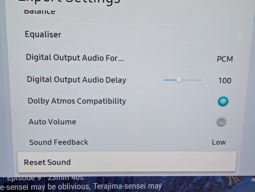

So PCM does not work? I have it on PCM in my TV settings. Should I select Dolby Digital?
I have some more options, but I am not sure what I should change, if anything.
Should I enable Dolby Atmos? I notice that if I do, that's enabled with the Google Streamer as well.
I could perhaps set my TV to Atmos and then force the Streamer to only use Atmos?
*update*, as it seemed logical, I've set my TV to Dolby Digital + Atmos enabled and I've set Chrome Streamer to "Manual", then enabled only "Dolby Atmos with Dolby Digital Plus" under the 'Supported Formats'..

I did the same thing, I set the TV and the streamer to Dolby Atmos and so far so good.
10-24-2024 09:38 PM
I won't fill out the form just yet. After setting my TV to Dolby Atmos and forcing the Streamer to use Atmos as only output, we've not had issues *knocks on wood*..
10-26-2024 03:06 AM - edited 10-26-2024 03:08 AM
I have not had issues since Thursday, since setting my TV + Google Streamer to Atmos (TV output + Streamer manual forced).
