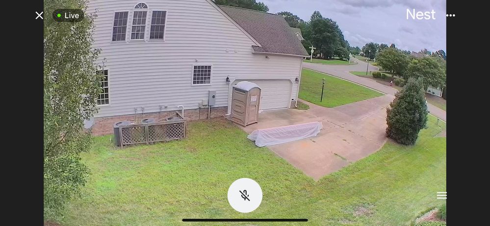

Well, my remaining Nest Floodlight Camera finally updated to v1.67. Here is the result. I understand the need to improve the image contrast, but this is ridiculous.
Nest v1.59 FirmwareNest v1.59 FirmwareNest v1.67 FirmwareNest v1.67 Firmware
Good example.
The v1.67 Firmware image is noticeably blurry compared to the v1.59 Firmware.
