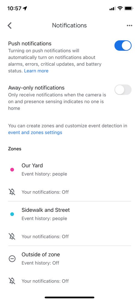

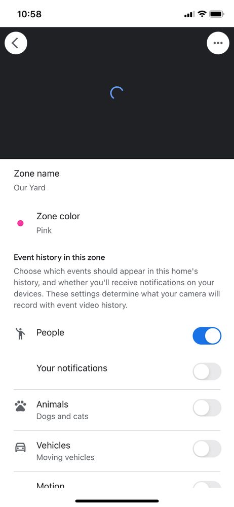

11-20-2022 09:17 AM
Customers who have the new 2nd Gen Google Nest Doorbell, do you not have these same options under Settings | Notifications that the Google Nest Camera (Battery) has?
Screen 1 shows our 3 Zones, with "People" turned on for "event history" but turned off for "notifications in the "Our Yard" and "Sidewalk and Street" zones, and "event history" and "your notifications" turned off in the "Outside of Zone" zone.
Screen 2 shows the "Our Yard" zone, with "People" turned on for "event history" but turned off for "your notifications".

Screen 1: all zones
Screen 2: "Our Yard" zone
Screen 3: "Outside of zone"

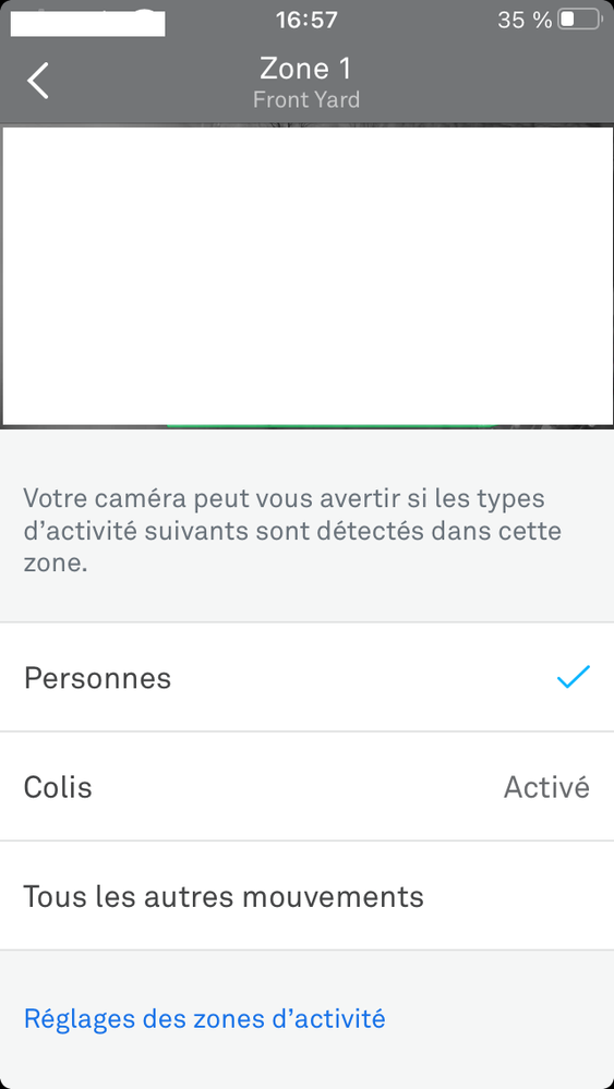

11-20-2022 02:06 PM
Thanks again. I do not have the same options.
Here are my screens. They are in French, but should not make a difference for the available options. Hors zone = outside of zone.
The first picture shows all the zones and the second one, the options for zone 1.

11-21-2022 06:26 AM
"Reglages des zones d'activite" is a link to list the zones and another link to create a new zone.
I have the regular Nest Aware, but that should not change anything because the difference is only the duration that the videos are kept.
In settings, I do not have a sub menu for "events". I have "Notifications" and "Familiar Faces"

Thank you for sharing your screens.
I changed my phone to English, and I now have the Nest App in English, but it is exactly the same screen as in French.
I do not have the same screens as yours.
I do not have a screeen called "Seen events"
Is it possible that Andoid phones and iPhones have a very diffrent Nest App? That is the only explanation left.
