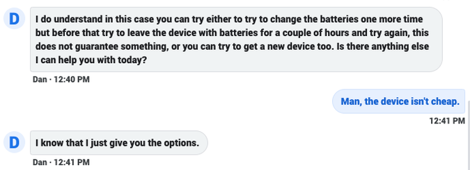

You must not have a "C" wire or Nest Power Connector installed with your 3rd gen learning thermostat.   Every time your nest thermostat runs your hvac it uses the battery and recharges when the hvac system is off. Those discharge/charge cycles degrade the battery just like in you cell phone and over time it adds up and the battery won't hold as much of a charge......when you have a "C" wire the nest never needs to power itself from battery so it never discharhes.
jimjimjimmy
Sure, buying a new one will solve that, but I don't need support to tell me that.
