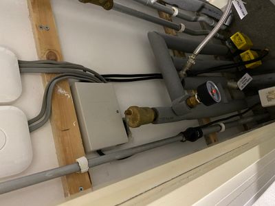

Can you take a picture of the Heat Link wiring? It would give me a clearer image of how the boiler is expected to work.

AnaM
Hey @JustinD,
Thank you for the pictures. Would you be able to take the cover off? Only if you feel comfortable doing so as that's where you can see the terminals and the wires.
JustinD
Does this work?  Shows both Heatlinks and the junction box.
AnaM
Yes, that's great, can you send a picture taken of one of your Heat Links closer, so that I can see all the terminals?
JustinD
Here you go:
AnaM
Thank you, @JustinD.
From what I can see, everything seems fine with the wiring, at least concerning the Heat Link terminals. Let's do a test, go next to the Heat Link and call for heat from your Nest app, listen for a click. Turn it off and listen for a click again. Do the same for the Hot Water if you use it to control that as well. Let me know what the results are.

Alright, thank you for doing this. Based on all the information provided, the Nest system seems to be working as expected. The wiring on the Heat Link also seems done correctly as far as it concerns the terminals, which means that you should reach out to an installer to have your boiler and the other parts of your heating system checked.
