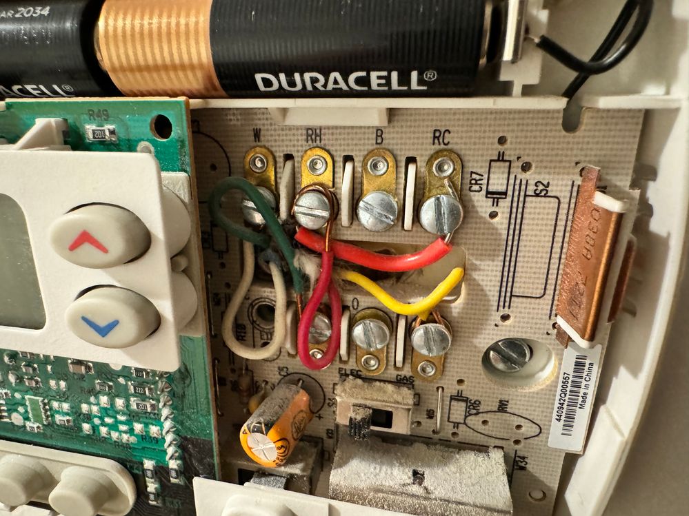

Hi all,
Apologies for my ignorance, but I can't tell if my system is compatible with Nest based on the compatibility questions.
Hopefully this picture of my system is enough for someone to tell if it's compatible or not. Thank you in advance for your help!

Thanks for posting here in the Community forum and for showing interest in our Nest Thermostats. Fortunately, your thermostat wires are compatible with our Nest Learning Thermostat 3rd generation and Nest Thermostat E and should be wired to their base as follows:
Also, here's a guide for the installation and setup of a Nest Learning Thermostat and Nest Thermostat E.

Thank you so much @zoeuvre! In that case, I will purchase it now and hopefully setup goes smoothly once it arrives!
