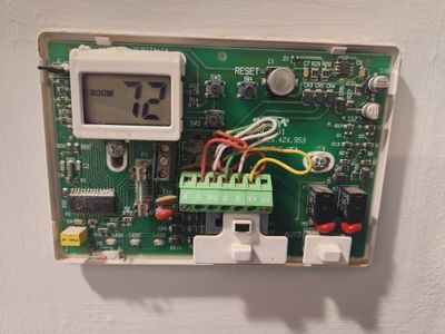

Here's a picture of my current system wiring. Is it compatible with this model?
@doublej2k
No, your current thermostat is only compatible with the Nest Learning Thermostat, 3rd Gen.
Wire it like this
Blue - C to C
Red - R to Rc
Orange - O to OB
White - W2 to W2 (set as AUX heat)
Green - G to G
White - E to * (set and emergency heat)
Yellow - Y1 to Y1
