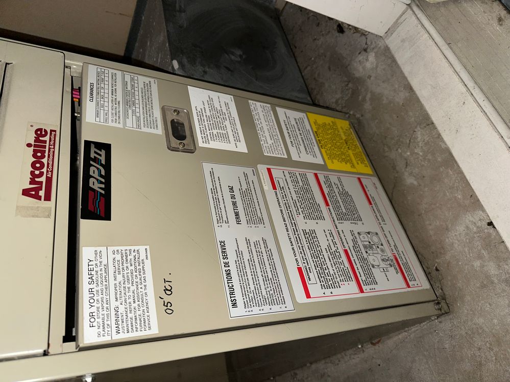

What type of Heating system do you have? Can you take a picture of it and it’s manufacturer label showing the model number?
Ken, The AC Cooling Wizard
Thanks for the response. (see below)
If this will work with Nest, I will purchase this bad boy tonight!
Thanks.
That is a forced air gas furnace and that is fully compatible with an Nest Thermostat.
Ken
Sweet! Thanks Ken. Just purchased my unit! Thanks for your help!
