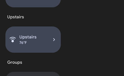

@rhanzlik thanks for the reply. The documentation is certainly limited about what is possible. I have received notice that other users are seeing their Nest Temperature Sensor in the Home app as seen in this picture.
To see if the sensors have been added to the Home app, open the app and scroll to the bottom of the page to the Linked to you section to see if they are available.
If not, you could try using the, "sync my devices" command on the Google Assistant to force the  sync of the temperature sensors.
I'll keep looking for more official documentation on what is possible to do with the Temperature Sensor in the Home app.
I hope this helps.
Brett
Brett:
The "sync my devices" appears to solve the problem, as the Sensors now appear in the Thermostat info in the Home app.  Access to the Sensor information is not as easy as on the Nest app, but is not a deal killer. Thanks for your help.
