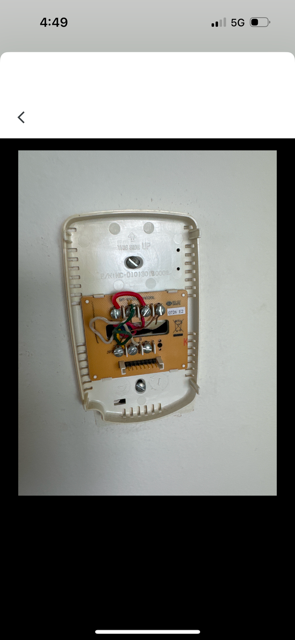

Hi Renz, Thank you for responding to my question. Please see the following photos from my new Google thermostat, my unit and old thermostat.
SamB1
With this connection everything is working, but I know that Y and W wires are connected to the wrong spots.
