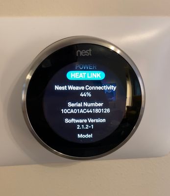

I'm sorry to hear about your issues, but I'd like to help you out. To begin with, I'd like to see a picture of the power readings which you can find on the thermostat's display in Settings> Technical Info> Power and a picture of the network details, which can be found in Settings> Technical Info> Network. If we're not able to isolate the issue based on these values, we'll do some troubleshooting steps.
RyanDavies
Here you go, it’s actually connected and working as normal currently, I had read about a power issue but when mine is disconnected the power readings were as they should be.

Thank you @RyanDavies,
The values look good. Please answer the following questions:
