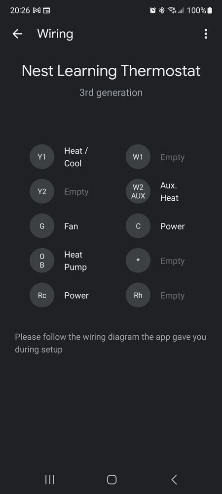

CoolingWizard,
What are your wiring recommendations for nest 3rd generation thermostat based on the cables above, the system uses a heat pump on? I have included a screenshot of what I think would be my setup but I'm not a 100% certain.
Yellow Wire goes to Y1
Black Wire goes to C
Red Wire goes to Rc
Green Wire goes to G
Orange wire goes to O/B*
White wire goes to W2/AUX
When comes the testing your system at the end of the installation, run the Heating test. See if your get Heat. Then you must wait 5 minutes minimum before testing the cooling.  Now if your Heat test blows cool air, then the reversing valve (the O/B) mode needs to be changed.  The  O model heat pumps are heaters  by default and you have to energize the reversing valve (OB wire)  in order to get cooling. Conversely, B model heat pumps are air conditioners by default, and you must energize the reversing valve (OB ) to get heating.
I hope this helps,
The AC Cooling Wizard

So far so good and everything is working fine!
