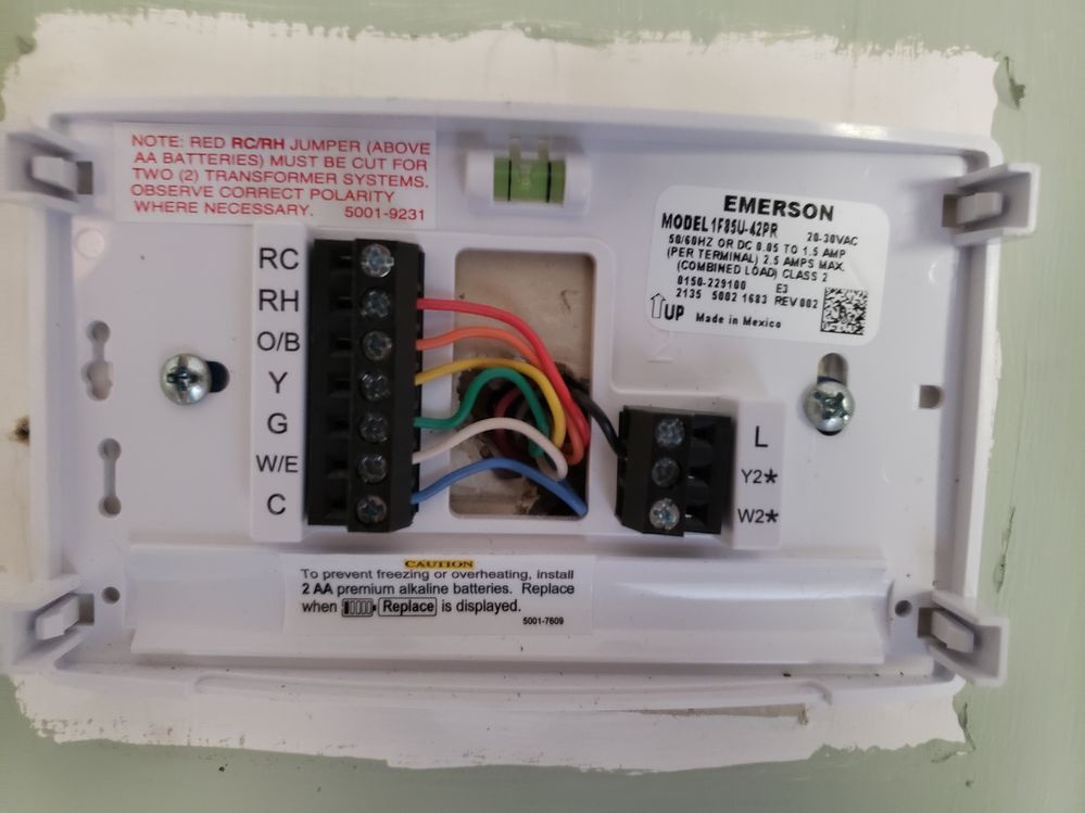

Hello,
I have purchased a Google Nest Thermostat (not the "Learning" version) that I want to install with my Amana ASZC16 series heat pump.  This heat pump has two-stage cooling and a two-speed fan motor.  I noticed on the Nest box that it says that "The Nest Thermostat can control...; and fans, one speed".  It was not clear to me if this meant that the Nest Thermostat will *not* work with a heat pump that has a two-speed fan.  Will this Nest Thermostat work with my system?  Thank you!

Thanks for posting here in the Google Nest Community. We'd be happy to take a look into this for you. @jmangum, send us a photo of your heat pump control board wiring and the previous thermostat wiring (if you still have a photo of it).

jmangum
Thank you for your help @RenzJ .  Answers to your questions follow:
  1. I am installing the "Nest Thermostat" (the first one listed in the link you provided)
  2. Attached is a picture of the current (Emerson) thermostat wiring:Current thermostat wiringCurrent thermostat wiringI am not sure where to find the control board wiring.  Perhaps it is in the spec sheet for my heat pump (Amana ASZC160481; https://www.theacoutlet.com/aszc160481-4-ton-16-seer-amana-heat-pump.html).

RenzJ
Hello jmangum,
Thanks for the update. I’ve reviewed the photo and heat pump details you sent us, and this can work with our Nest Thermostat. But for the two-speed fan, you can wire it as it is, but it will only operate the fan as a single-speed fan.
