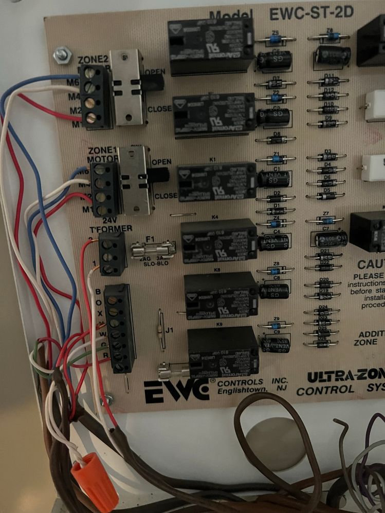

I am trying to replace my old honeywell thermostat with Google nest. I am having trouble with the wiring. Any help will be greatly appreciated. Please see the attached images of the old wiring and the new one.
After the nest setup, it is NOT recognizing Y and C and started recognizing the O/B as heat pump. Mine is a Gas Furnace. Not sure why it recognizes the OB as a heat pump.
I mapped G to G, R to R, B to C, O to OB, W to W and Y to Y.

Thanks for getting back to us. Can you tell us what is the make and model of your HVAC system? Also, please send us a photo of the other end of your thermostat wires connected to your HVAC control board.
raghuganji
Hello,
I took some pictures of my HVAC wiring. Attaching the pictures. Please take a look. Thank you for your response.
IMG_8923.JPEGIMG_8924.JPEGIMG_8925.JPEGIMG_8926.JPEGIMG_8927.JPEGIMG_8928.JPEGIMG_8929.JPEG
