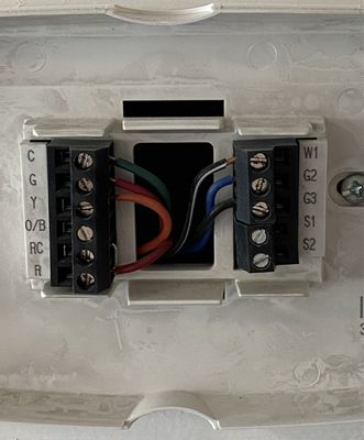

I recently obtained a Nest Learning Thermostat, 3rd Generation, and I require a wiring diagram for its installation. If anyone in the community possesses a wiring diagram for this specific model, I kindly request your assistance. Your help would be greatly appreciated.
My current thermostat wiring is like following.

Your system has a 3-speed FAN. And strangely it looks like there are two separate red wires.  Your wires will be
normally for a configuration like this, you will need to hire a Nest Pro to perform the configuration setup.  G will be FAN speed 1, Y2 is FAN speed 2, and * is FAN speed 3.

It works! Thank you for your following up

Yes, it works! Thank you for following up
Thank you for your help. I have installed following your instructions.
