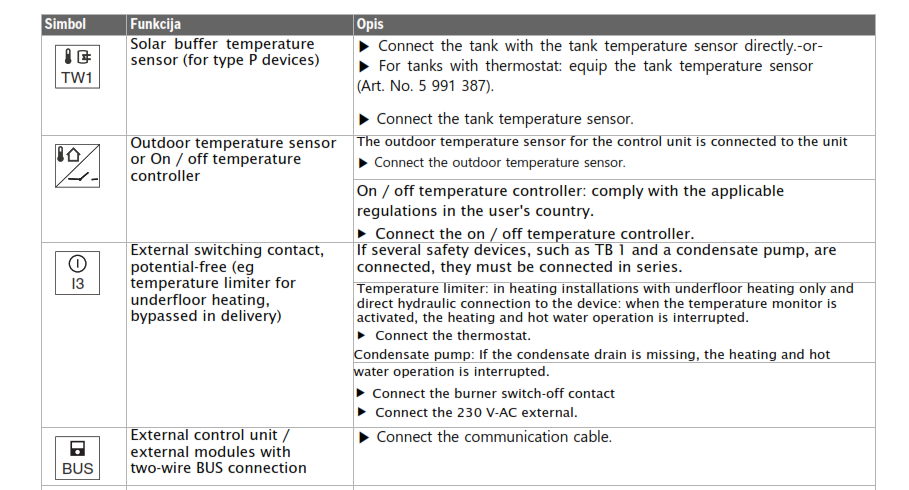

Hi guys, did anyone have any experience with connecting the Nest to the gas boiler from Bosch, model Condens 2300 W?
I am having a hard time with the installation because my old thermostat only had 2 wires (COMM and NO) and I did not receive any significant help from the Nest support regarding where to connect these 2 wires or any additional wires on the Nest.
The 2 wires connecting to the thermostat are on the blue terminal as shown on the picture below:
Blue terminal is used for the current thermostat
The functions of the terminals on the boiler are as described below:
Please help, if anyone knows this I'll buy him a drink 🙂

You either need a 4 wire run to the thermostat as it requires power or a stand for your thermostat (which provides power) and it will connect wirelessly to the nest control box. I have a boiler that just requires the 2 wires as well.
The control box connects to the boiler via the 2 wires (all clear in the instructions and inside the box) and the thermostat communicates wirelessly with the box.
All that assuming your using the same Nest Thermostat 🙂 Control box (boiler end)
Thermostat Living room
11-16-2021 07:39 AM
And to try and be clear... The wires you show are literally going to an on - off switch controlled by the thermostat but the thermostat requires power so there should be a positive and neutral wire as a power supply going to as well. If it is connected wirelessly all it needs is the power wire. It is all in the manual.

Thanks for the swift reply @MarkEllis . The thing is, I did not receive the control box with my Nest, I only have the nest base to connect the wires to. Do you think I need that control box in order for this to work properly?
11-24-2021 12:42 PM
Absolutely you do for it to work. The control box is the brains it is also a connection to the internet so that you can manage your boiler from your phone. There are other great features like turning off the heating when you go out.... because it know when you phone left home ( if you have one). It is alto the thing that works out the best setting for you heating automatically to the rooms are warm when you want them to be and start to cool when your about to leave. All clever stuff and the control box does the switching.
