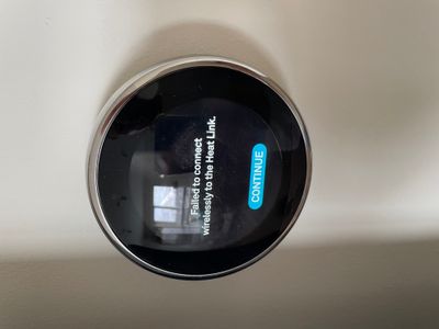

Hi Vladut, thanks for this comment. I did not do the device installation originally but I was under the impression my Nest Thermostat wires are only power source and not control wires. Are you saying those wires are actually used also to control the Heat Link?
Note that when I try to check wireless connection it never sets up (see image, constant connecting sign). And also sharing the status of connectivity on the device. I was under the impression the Thermostat only controls Heat link if the wired connection is set up, could confirm this is not correct?
WhatsApp Image 2023-07-25 at 13.44.35.jpegWhatsApp Image 2023-07-25 at 13.44.34.jpeg
LarisaL
Hi there! The wires from T1 and T2 are used to power the thermostat and also to create the connection between the Heat Link and the thermostat. However the thermostat can wirelessly connect to the Heat Link, but in your situation is already connected via the wires so the wireless connection is not needed. The thermostat can control the Heat Link as long as it is connected to the Heat Link (wired or wireless).
