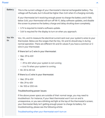

Reading more about the power settings for the Nest Thermostats, if you have C wire then you would get 100 or 200 mA for "lin". I thought putting in a Nest Power Connector would provide similar power readings as if you had a C wire, but it reads the same as if you did not have a C wire. What I'm trying to get at here is how do I tell the difference if the Nest Power Connector is working properly?

 With the nest thermostat running for a few days now, I do notice that the system is charging the internal battery. When I first installed the 3rd gen Nest thermostat on the first day, I saw the battery voltage was like 3.67 - 3.72 V. That makes sense because it was just sitting in packaging on a shelf at some warehouse for some time now. After 24 hours I noticed that the battery voltage jumped to 3.87 and now it remains around the range 3.84 - 3.9 V. That indicates that there is enough power to charge the Nest thermostat battery. Now, I did not install this without the Nest Power connector from the beginning so I do not know if I would had any issue without using the power connector or not. I figure it was best to install everything at once so I wouldn't have to go back to make any changes. I did read somewhere online that someone else wrote an article about the Nest Power Connector and said that the 3rd Gen Nest Thermostat doesn't detect the power connector. Maybe this is something they can provide a software update for in the future, since the Nest Power Connector was just released around May 2021. Comparing the battery voltage level to another home where I installed a 3rd Gen Nest thermostat with a C-wire, it gets like 3.93 - 3.99 V. From the Nest thermostat documentation, it stated that only 3.7 V was necessary for normal operation without issues.

Same questions here. How do you know if it's working? C-wire shows in diagram? 100+ mA lic? 3.9V battery? Doesn't appear to be working by those metrics...

Google doesn't seem to want to state how to tell what voltage levels are to be expected with or without the Power Connector.  I have it installed but still see the display unit complaining that the Nest App has low voltage.  My furnace is off most of the time, the Vin voltages are both around 35 to 36v and the unit gets 40 ma.  Are those the expected numbers?  Why does the voltage of the battery still go below 3.7v on a regular basis?  I have to turn the whole thing off in order for the battery voltage to recover.

The Nest Power Connector didn't work on our simple heat only furnace system and we returned it. I ended up giving up Fan only control by moving the G wire to the C terminal and it worked. Battery now at 3.91V and lin at 200 mA. C wire shows up in the software wiring diagram, confirming that it recognizes the C wire. We didn't use fan only mode and the heat blower/fan works fine. Simple Youtube video:
