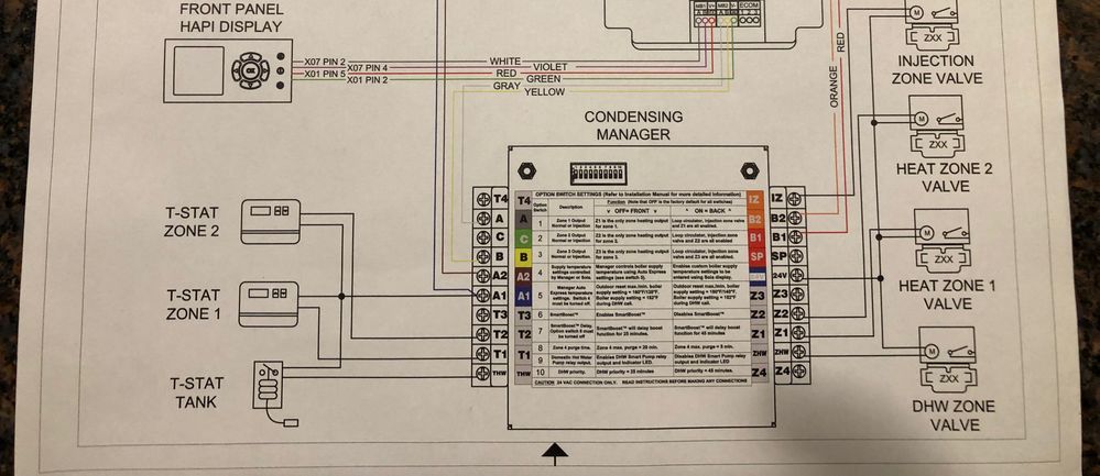

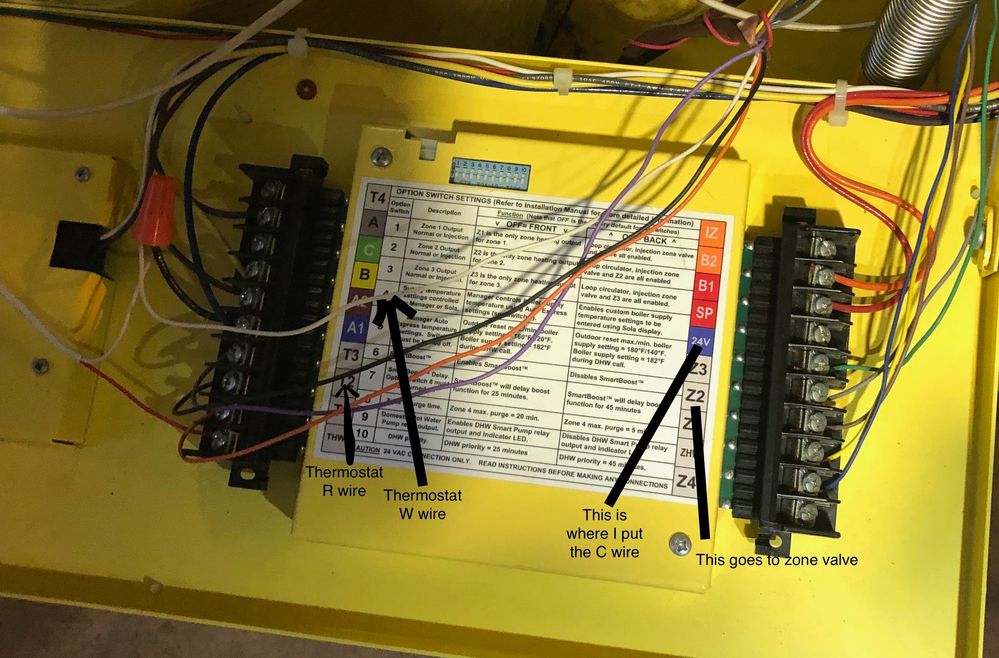

You need to post a picture of how the original thermostat was wired and how you have wired the Nest products.
mohonkjoey
The two Grey wires (W and R) for the nest power connector are connected that are indicated in the first picture of my control panel.    The C wire is connected to the 24V.      The right side of the Next Power Connector (the white wire C and W) are connected as follows:   C=T2 and W=A1
Is this for a multi-zone boiler system? What is the make and model number for it?
The "C" terminal is the common aka return for the 24VAC.
The thermostats for this system looks like they are just simple two-wire thermostat and they only provide a switch closer to the system.
I'm truly surprised that you haven't blown some fuses.
Yes, its a multi-zone boiler system.   Make:  System 2000 Energy Kinetics Mode: EK-1C.
Yes, I only have 2 wires for the thermostats.
No blown fuses yet!  Thermostats function normally the way its connected in the pictures.
