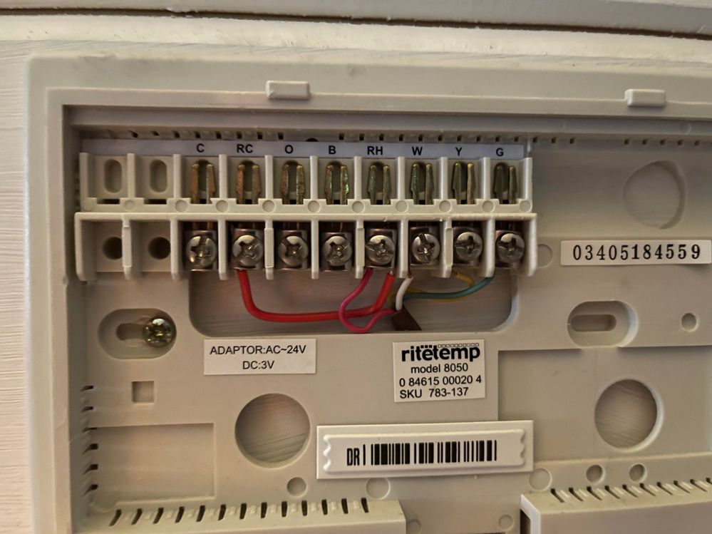

Green, Yellow, White with RH RC jumped , will Nest work with this?

Nest would work but you’re a missing a wire that would connect to C to power up nest all time. Otherwise you have to keep charging it from time to time. You can use the 4 wires only that you have & rewire system to get power but you would loose the ability to use the fan only function. Good luck.

Thanks for the response but can this control both heating and A/C with just the red wire used?

it can need to connect
red to Rh on nest
yellow to Y/Y1
white to W/W1
Green to G
good luck

Hmm must have a different nest thermostat only has R no RH
Ok that’s fine you connect to R they have different models didn’t know which one  is yours. Good luck.
Thanks for posting in the Google Nest Community forum. I'm sorry for the delay. It looks like you have a conventional system. It is compatible with the Nest Learning Thermostat or Nest Thermostat E. However, if you prefer to have the Nest Thermostat 2020, you might be needing to have a C wire of a Nest Power Connector.
Wiring guide:
  • W/W1 - White (Heating)
  • Y/Y1 - Yellow (Cooling)
  • G - Green (Fan)
  • R/RC/RH - Red (Power)
You can visit this support article for more information.
