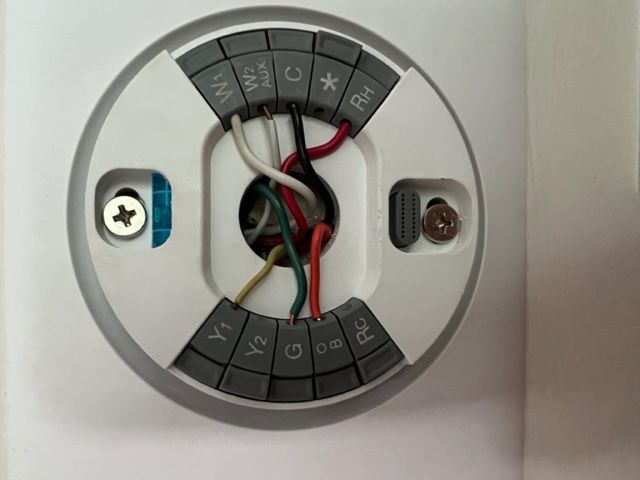

So I removed the NEST and the wiring looks correct and it shows the same on the screen of the unit. See attached
WiringWiring

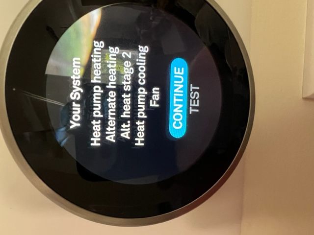

Then I went into the configuration and it looks the same. See the next few photo's

Your setup in the pictures are setup for heat pump.  When on the test screen, did you try Heat Pump Heating and Heat Pump Cooling? And did they work correctly?
Ken
