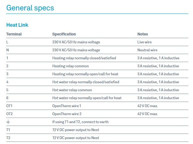

This will help you as everything you need is clearly shown, Like you say it's a basic install.
