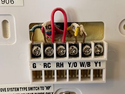

Trying to figure out if this is compatible with the nest thermostat. Here is my current wiring layout. I know the jumper will go away.
please advise, thanks in advance

Yes it will work.
Put Red to R
G to G, Yellow to Y, White to W
If you have a spare wire in the cable you should connect it as a C wire but you would need to also go to the furnace and take cover off and find the C screw and connect it there also.
The Nest might work without a C wire but it's always best to connect it if possible.
Thank you! I will check that out this weekend.
