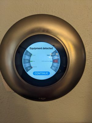

@Nestdogg82 , You need to reinsert all wires, attach the display, then Goto SETUP > EQUIPMENT. It will show you a picture of the backplate and the wires that are detected.  Take a picture of that and upload it here.  After that continue until you can choose DONE.  Then Go to SETUP > TECHNICAL INFO > POWER,  take a picture of the power information. You and close pull up BASE information while in TECHNICAL INFO. Take a picture of that and upload it here.  Below are my pictures of this information I am seeking.
Equipment Detected DisplayEquipment Detected DisplayBase InformationBase InformationBattery  and power informationBattery and power information
