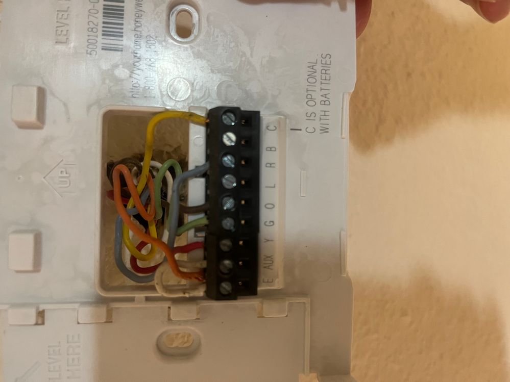

Compatibility chart says system is compatible. Electric Heat pump with emergency heat. But during setup I get a message that Nest is not compatibility. I put the E wire to W without jumper and O to o/b in nest. Others as marked.Existing wiring on TH4110B

@DKM, thanks for getting back to us. We see two white wires in the photo, one is at the back of the wires and we can't see the end of it. The other one is like a jumper that's connected to the AUX and E terminals. Please check where the other end of the white wire at the back is connected.

Thanks. White wire in the background is not connected to any terminal. Visible white wire in foreground is a jumper from E to AUX.

@DKM, thanks for letting us know. In this case, the visible white wire that jumpers from E to AUX should be connected to * terminal of the Nest Learning Thermostat base. Below is the illustration for you.

Do you mean the orange wire that’s connected to E ?? White jumper wire connects E to Aux.

Thanks for the clarification—my bad. The white jumper wire should not be connected to the Nest Learning Thermostat base; instead, the orange wire should be connected to the * terminal of the Nest Learning Thermostat base to work with your emergency heat.

See my reply above. This Nest thermostat doesn’t have a * terminal.

Gotcha. For your heat pump system with emergency heat, I recommend you install the Nest Learning Thermostat 3rd generation instead of the Nest Thermostat 2020 that you have since only the Nest Learning Thermostat can support a system with a separate heat pump wire and emergency heat wire, unlike with the Nest Thermostat 2020 that you have to choose with either your heat pump wire or emergency heat wire be connected to *OB terminal.
