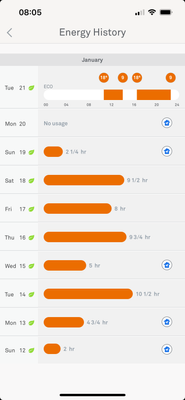

Many thanks. I am currently away, I left on Sunday 19 Jan. Nest recognised I had left and turned off heating. It stayed off on Monday 20 Jan but on Tuesday 21 Jan it turned the heating on for 9.5 hours. The home/assist activity history records no events. This morning the home page shows me as away but the heating is turned on, pre-heating to 18.5, but was at 13.5 when I checked at 8 am.  The eco setting I have is 9, so it is unlikely the heating was triggered by that temperature. I have turned the heating off remotely now. Yesterday I checked at 8:00am but the heating did not turn on until 11:00. Screen shots below.
Fifi16
My problem predates the 14th Jan update that others are concerned about. I reported it in December, but my problem goes back to at least May 2024. The second way my concern differs from this new thread is that my home/away is linked to my phone whereas these concerns are all about detecting activity in the building when there is nobody there. I don’t believe the decision to merge my thread with this new thread is helpful.
