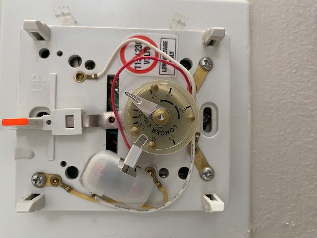

Sorry for the ask, but I need some help with the wiring. My system is compatible in regards to the power. The existing thermostat is a Lux T101143. On the HVAVC, I see a G, R, Y, W, and another R going to Y (guessing Rc) and then a white wire connecting to the Common 24v. There is a blue C wire not connected to anything out of the picture. Then on the thermostat, there is a jumper Rh/Rc and R connected to the Rh, Y, W, G, and the C is connected to B. For the Nest configuration, I put R to R, Y to Y, W to W, G to G, and C to C. Nothing. What am I missing? Should I do C to o/B? Then there is not charging of the Nest, correct?

Thanks Jake for the help. Unfortunately, the articles did not help. If you're able to view the top image, it shows a white wire in the Com 24 V rather than the blue common wire. The blue wire is unused and coiled around the R, G, Y, W wires that slot into the board. The white wire in the Com slot is with the red wire that is slotted with the yellow in Y. It's a crazy set up for the furnace. My theory is since there is a rc and rh jumper, that the red wire that joins the yellow in Y, is the rc and the red wire in R is the rh. But it still remains of how do I set up the Nest based upon the existing wiring structure?
