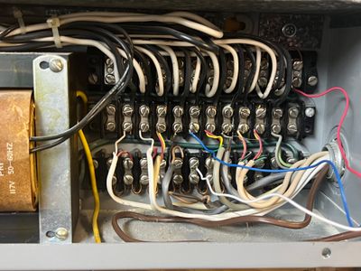

Please post a picture of the original thermostat wiring here if you have one.
