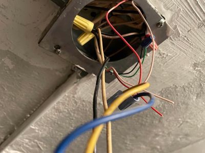

I have a two-wire heating system running my gas boiler and radiators. I bought a 2020 Nest, and quickly found out it doesn't work without C wires (which my system doesn't have). I purchased the Nest Power Connector, and then began looking for the wire terminals on my boiler, which were nowhere to be found. I finally figured out that they are in a junction box on the ceiling. It's a rats' nest of unlabeled wires, although I think I can figure out which two are connected to my thermostat based on the colors. My next realization: I cannot find a single electrical outlet near this ceiling box. I'd have to pay to put in a new outlet to use the adapter which I'm not even sure will work with my system. I'm attaching pictures of the junction box.

The blue and yellow are the 24 volt AC.
I can't tell which one is connected to red but the other one is common.
So if you can pull a new thermostat cable use 5 conductor wire and use red white and blue at nest blue will be common C.
Then connect blue to to the transformer wire nut which ever is not hooked to the red. I would not use the nest power device just run a new thermostat cable if possible.

Thank you, Mel. I have to figure out if I can fish a new thermostat wire through the wall on my own to make this work. If you have advice beyond what @Houptee generously shared, let me know. Otherwise, I'll give this a go.
