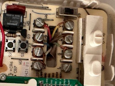

After installing my Nest Learning Thermostat I am only getting cold air from my vents and house temperature drops. I wired the thermostat according to the diagram on the screen yet I am cold! Please help?

Looks like you have a Heat Pump system.
Do you also have Auxiliary heat? Maybe a gas furnace for backup heat or is it electric emergency heat ?
Do not use any jumper wires on the Nest (your old tstat has jumper on white).
Put White wire in W1 on Nest.
Do you have the OB wire and the C wire connected to Nest?

You old thermostat has the Emergency and Secondary heat wired together. You only have Heat pump heat and auxiliary heat.

Your HVAC system is a Heat Pump with Electric Heat Strips. Your Heat pump control wire is Blue, the compressor control wire is Yellow, The Blower Fan is Green wire, Your Power IN is Red wire and your Power Common is Brown wire. Your white wire is connected to both Emergency Heat and Secondary Heat. Your Nest set up should be:
Primary Heat: Heat Pump, Forced Air
Secondary Heat: Electric, Forced Air
The heat Pump reversing valve is controlled by the O/B (blue wire). Now, some heat pumps are default Heat Mode, and some default to Cooling mode. The O/B wire, when energized, changes the mode. so, it will be change from Heat to Cooling or changed from Cooling to Heat. The nest will allow you to change the O/B function. You set it to energize for Heat, or to energize for cooling. If you have set your equipment type correctly, and as you say, heating is cooling, go into to equipment settings and change to current O/B mode to the opposite. Then retest the heating system. BTW, if it is currently programmed backwards, put it in cooling mode and you should get heating.
Your wire setup on the Nest will be :
RC is Red Wire
C is Brown Wire
Y1 is Yellow Wire
O/B is Blue wire
G is Green Wire
AUX is White Wire

Mr. Perry, please be specific, and tell me exactly what you did to test. And how about posting a picture of how you have the nest backplate wired so we can make sure you wired it correctly.

You can certainly do whatever you wish. In my years of installing and configuring these Nest thermostats, I have never encountered a situation where the Nest Thermostat did not operate properly when initially installed. I have been called back to homes where the customer states it is not working and In 100% of the callbacks we have discovered that the customer began changing the thermostat and as a result created the problem that caused the heating not to work or the cooling not to work properly. All we do is reset the thermostat, configure it properly and put them back in service.
I also find on this public forum, that many people who report a problem, do not provide the necessary information for us to help them the best. Customers who call on this forum for help should immediately upon opening the ticket upload the configuration of their thermostat, upload a photo of the back plate of the old thermostat and a photo of the back plate of the nest thermostat I don’t know why that logic fails over and over.
