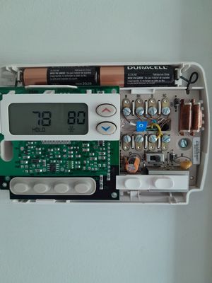

This thermostat is the master in a 3 zone system - no heat pump, forced air and oil heating but we still have o and b wires. I have installed the slave, with a C wire adapter (Green to C wire, Y and R, no O or B) and the system works. Now I am stumped as the master has the following wires (in the photo):
Top - W   Rh  B   Rc  (jumper between Rh and Rc)
Botttom - C (G into C and labeled, with the C wire adapter)     O    Y
B wire is Blue and O wire is Brown. Obviously both cant go into O/B in the Nest. Have seen suggestions to make the O into C and the B into O/B in the Nest (to control heating/cooling, and which will leave the current C wire (previous swapped G) out).
Any help highly appreciated!

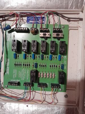

hram_2-1692141641964.jpegYes - planning to buy two Ecojay Smartzone 2x panels, and adding photos of the attic (above) and basement (below, with the jumper). I am confused about the wires in the Motor contacts in the EWC panel - they probably go in the Damper contacts in the Ecojay panel. Also, I have a total of 5 thermostats/5 zones, where 2 are masters (with o and b both wires), 2 are slaves (no o or b) and one is a question mark (has a B wire, no O wire). So should I get a two 2x panels to replace or should i get one 1x and one 4x panel - and where would the wires go on a 4x panel? I have reached out to Ecojay too if they could help before I buy rather than buy and replace... Appreciate all the help!
Attic panel
Basement panel - you can see the red jumper
@hram ,
That jumper wire is on the Equipment side. they are sending 24VAC out to the HVAC equipment or getting power from HVAC equipment. Normally there is a separate and dedicated transformer just for the EWC ST-2E.  The dedicated transformer is normally wired to the Transformer Block.  In your case, they are getting the power from your forced air handler.  On the transformer block the #1 is Power Common and the #2 is Power 24VAC.  The installer seems to have wired the Red wire to Common terminal.  To verify this we need to see where that red wire goes off to.
Your zone damper motors are power open and  power close. On the damper motor connections, M1 wire is Power Common, the M2 is 24VAC power, the M4 is OPEN, and M6 is CLOSE. The M1 common is wired internally from the Transformer Common block terminal #1.  When a thermostat call for service, the ST-2E sends power to the M4 damper motor to open the damper.  When the thermostat controlling that damper is satisfied, the ST-2E sends power down the M6 wire to close the damper.
The EcoJay has the equipment and thermostats connections on opposite sides than the EWC ST does.  Since neither of your current zone controllers supports more than two thermostat and two zones connected, the 5th thermostat must have its own equipment or it is attached to something else.
I hope this helps.
AC Cooling Wizard
