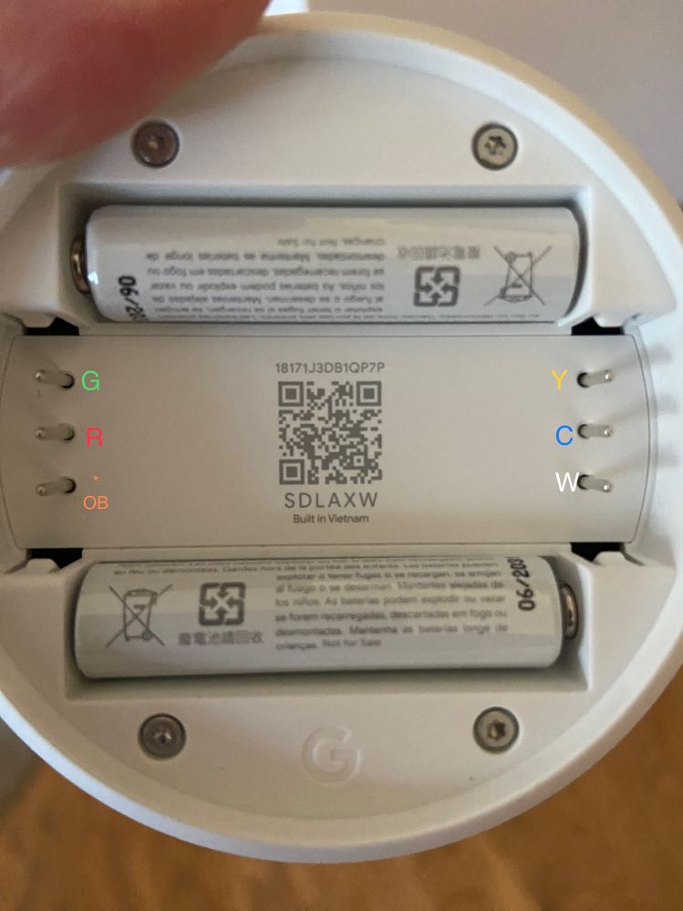

Did you purchase this Nest as a new product or used product?  Can you turn the thermostat display over and get me a picture of the back of the display please?
Ken, The AC Cooling Wizard
NestPro, Google Pro, Mechanical Engineer and HVAC service company owner. If my answer solved your problem, click Recommend this Answer below, and If it helped you, please give a Kudo.
mnman
I purchased it new, I installed one at my previous home and had zero issues so I'm very perplexed!
mnman_0-1666976255268.jpegI can tell you that I am as perplexed about it as you are. It makes no sense that it’s not picking up the signals. That implies to me that either the thermostat or the base plate is not properly manufactured or something like that. By chance do you happen to have a volt ohm meter and a couple of metal paper clips?
