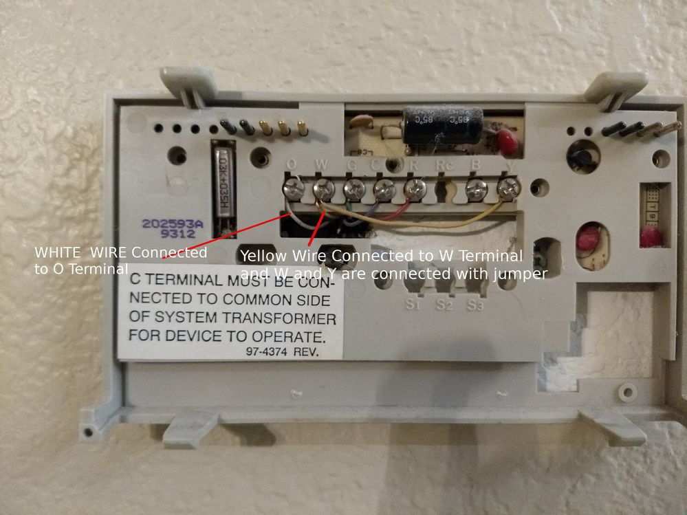

In existing Honeywell ChronoTherm III T8601C  (with wires R, G, B, W, Y ) .  White wire is connected to O terminal ,  Yellow wire is connected to W terminal. Also W and Y and connected using jumpers.  I want to replace this with Nest. Need help with wiring.

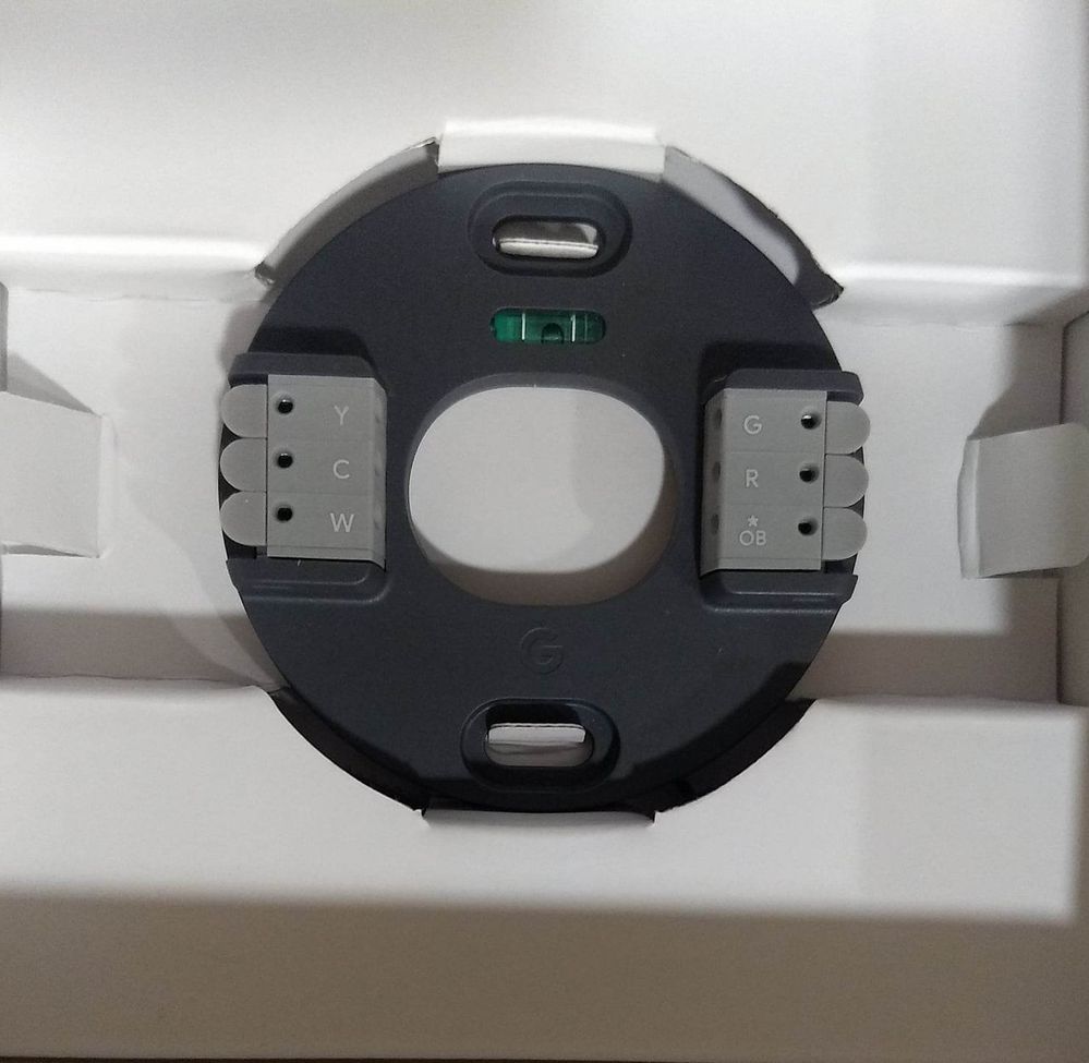

Nest terminals are as shown in pic

White - O to */OB
Yellow - W to Y (jumper to Y not needed)
Green - G to G
Blue - C to C
Red - R to R
Update:   I have Heat pump model  CPE30-1AB Goodman heat pump.  Very Old Model but runs gr8...running for 30th year.
