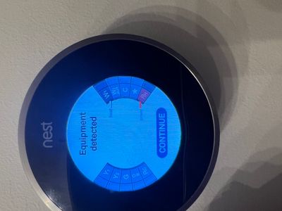

I have the same question

@Natalymartinez, I appreciate you posting the picture of your Nest thermostat. To clarify, does your thermostat only have 2 wires (W & Rh)? Also, could you share us a picture of your previous thermostat wiring configuration?
