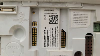

I have no earthly idea with only those two wires the system would work at all. What is the make and model number of your thermostat?
 Honewell TH8321R1001
rDraut
Apparently, it works with a Honeywell equipment interface module or with truezone wireless adapter.
Yes indeed, it uses a Honeywell RedLINK to communicate wirelessly with the HVAC Equipment.  The Nest Thermostat cannot do this.  Your thermostat cable in the wall would need to have more conductors and the HVAC equipment would need to be rewired.
