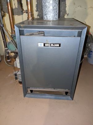

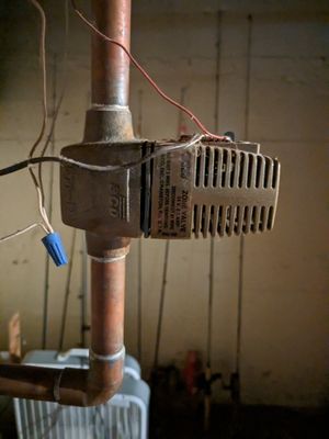

Here are a couple pics, including one of the zone valves. There is not a manufacturer label that I could find. I just have the basic Nest thermostat that has battery.
front of furnacefront of furnace
side of furnaceside of furnace
zone valvezone valve

Thanks for reaching out to us. To check more for the compatibility of your system with our Nest Thermostats, please help us with an exact photo of your HVAC control board where the other end of your thermostat wires are connected. In most cases, the control board can be found at your furnace or air handler.

zone valvezone valveside of furnaceside of furnacefront of furnacefront of furnace
The wires are split and connected to the zone valve (1st pic) and switch on side of furnace (2nd pic).

I guess I'm still a little confused. I don't have HVAC, so I don't have an HVAC board. The other end of my thermostat wires go to the zone valves and the switch on the side of the furnace (which I assume powers the circulating pump, etc). Those are the pictures I posted previously. My furnace is natural gas/hot water heat.
