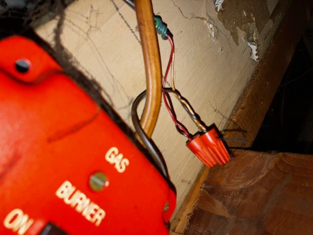

 Houptee, thanks for the reply. See my pictures of present (heat only) thermostat I have. In First Post.  My system is Gas, water heater. To radiators. Boiler is Crown Jamaica Series. Gas fired water boiler.   These are pics of wiring near the boiler in the basement.  Have no idea what is going to what.
Ok looks like you have spare blue wire wrapped around the brown thermostat cable.
You can use the Blue for the C wire.

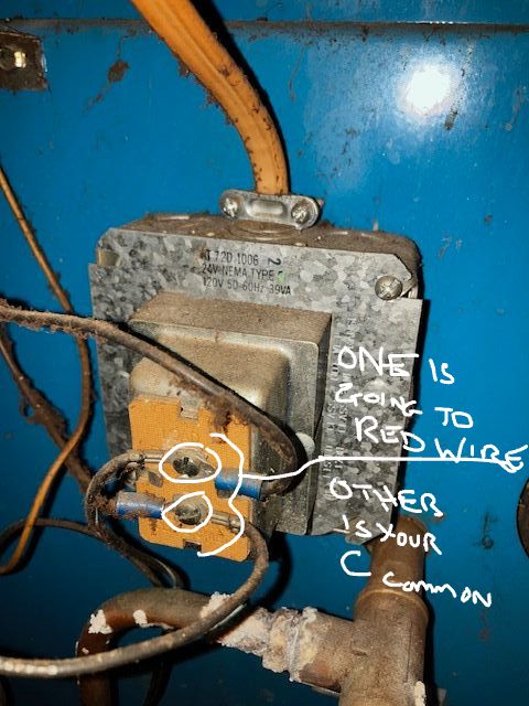

Now you have to follow the Red wire back to the transformer (looks like they spliced Red to one of the Black wires that goes to the transformer screw).
The other screw (not the one Red goes to) on the transformer is your Common aka C wire connection.
So connect the Blue spare wire to the transformer C screw and then at the Nest connect Blue to C.
Then Red to R and White to W on the Nest.
You should mark the black wire that goes to Red wire and also the transformer screw with some red nail polish if you have some when you figure out which screw and wire is red.

All you have to do is look at the brown cable in your pic it has Red and White coming from the Nest correct?  So you then look at the red wire, it splices to a black wire, it then goes to the transformer. Yay you just figured out your R + side of the transformer! Mark it with a dab of your wifes red nail polish.  Now the other screw is the C Common terminal of the transformer.  Go back the thermostat cable unwrap the wires they coiled around it and hook blue to the C screw.
Then hook blue to C on Nest.
Now you will always have a C wire if you change to a different brand down the road etc.

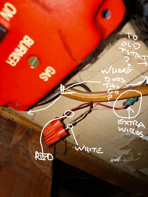

I marked up your pics to see if you can answer my questions of which brown wire goes directly from boiler room to the old Tstat.  One of the wires with the wire nuts must go up thru the house to the Tstat. Does it have extra wires coiled around the wire coming out of the wall behind the old Tstat or is there only 2 wires in the cable behind the old Tstat?

OK so both the brown cables go to the thermostats (one you no longer use for 2nd floor).
Just figure out which brown cable is for the downstairs thermostat and follow the red that wire nuts to a black wire, then the black goes directly to the screw on the transformer correct?
That is your R on the transformer, the other screw will be the Common of the transformer.
Its like a battery Red is + (positive) and Common is - (or ground).
Just connect the blue (extra wrapped wire on the brown cable) to the Common of the transformer.
Then go to the Nest and connect blue to C on the Nest.
The Switch with the Red plate is all you need to turn off that shuts off power to the boiler you do not need to turn off the power to the house jut turn off that red switch before you do the thermostat wiring,
No need to snake any wires up the walls at all just connect the one wire by the boiler (The Blue  coiled wire to Common on the transformer).
