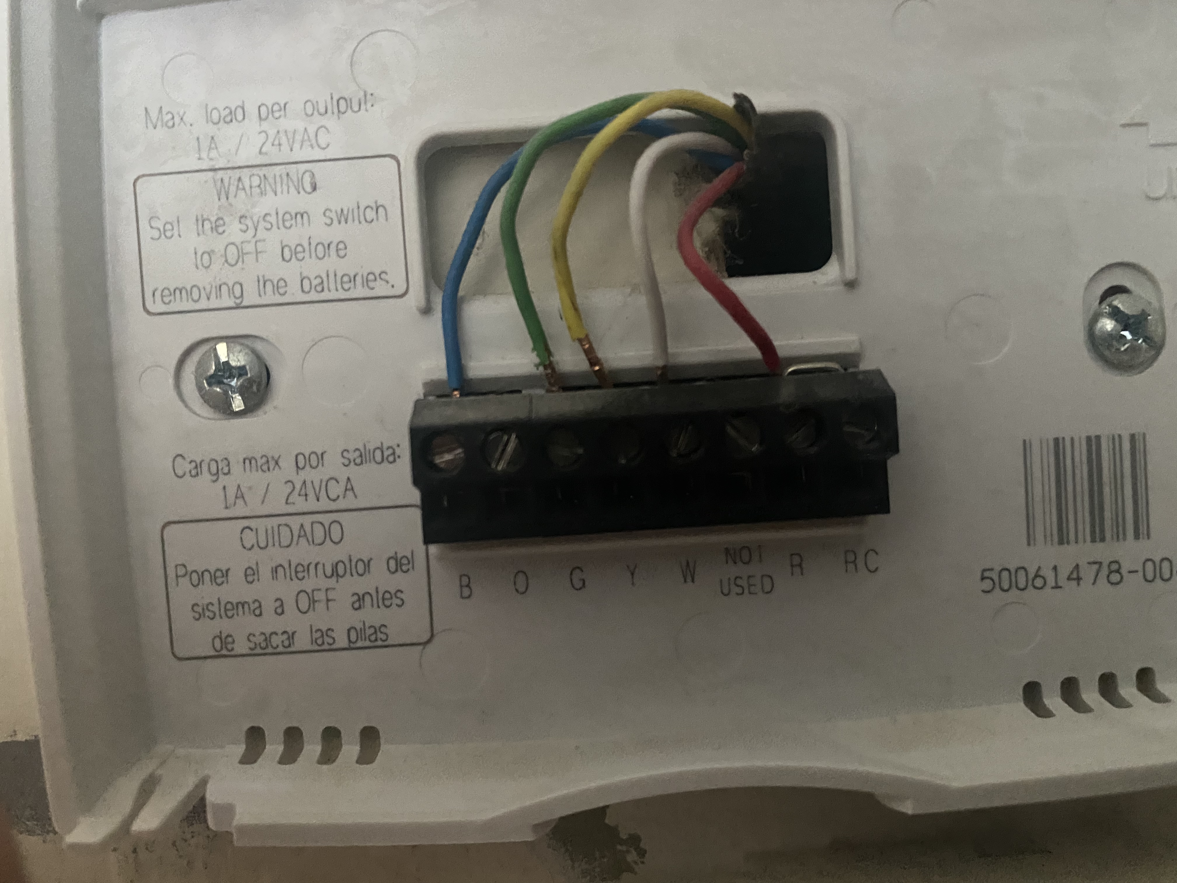

Does the blue wire go into the slot for C or O/B on the Google Nest (none learning) Model GA02081-US?
It’s a gas furnace system. Here’s the wiring at the furnace.

Yes, that blue B-wire is plugged into C. This is your common wire, which will help keep your thermostat charged consistently via your HVAC system. O/B wires control your changeover valve (i.e., switching between hot/cool) for heat pump systems. It looks like you're set!
However, if you run into any issues with setup, please reach out back here. Thanks!
