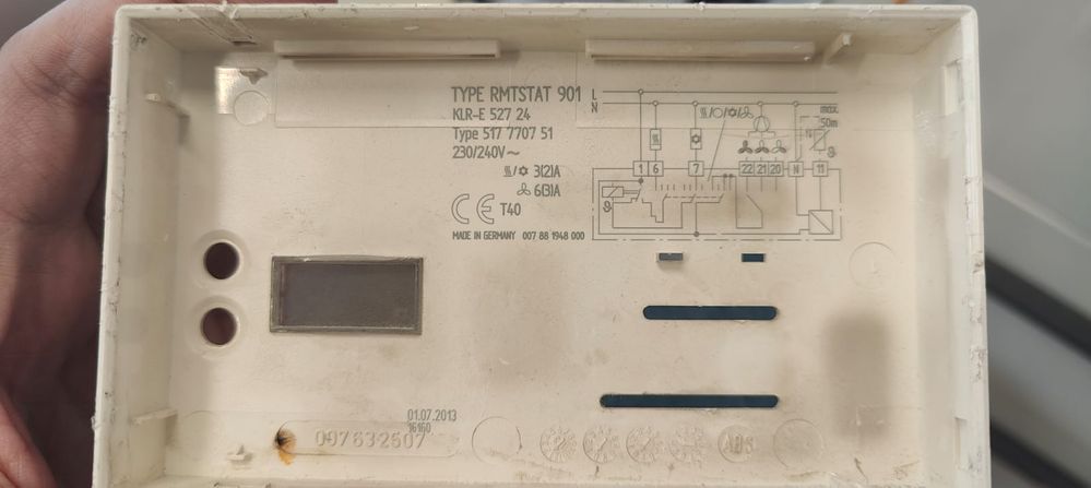

want to check the compatibility for this Trane HVAC system  is it works with google nest thermosta
Nasserbilbssi
is it works with google nest thermostat
please Help
WhatsApp Image 2023-07-27 at 14.45.263.jpgWhatsApp Image 2023-07-27 at 14.45.262.jpgWhatsApp Image 2023-07-27 at 14.45.26.jpg

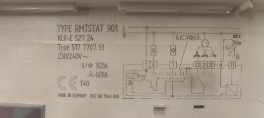

@Nasserbilbssi , that system uses high voltage control. The conventional HVAC control systems are low voltage. That is 24VAC and yours is 230VAC.

so it's not possible to apply Google nest on it ?
and is there any recommended device that can be applied on google home that can work on my old HVAC
please help me sir
@Nasserbilbssi , Goggle does not manufacture a high voltage Nest Thermostat for user here in the USA. I notice your thermostat has the temperature listed in Celsius. Are you living in the UK?
